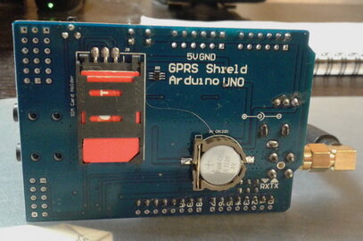

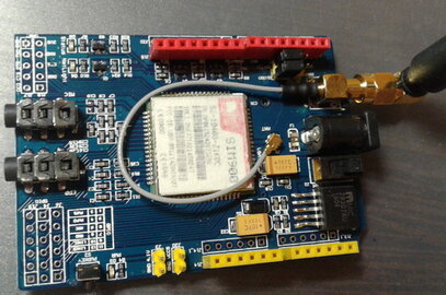

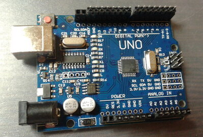

Гость angelv Опубликовано 25 Января, 2016 в 19:25 Жалоба Поделиться Опубликовано 25 Января, 2016 в 19:25 (изменено) имею девайс на SIM900. подключил напрямую к UNO. заливаю стандартный скейтч SMS receiver. /* SMS receiver This sketch, for the Arduino GSM shield, waits for a SMS message and displays it through the Serial port. Circuit: * GSM shield attached to and Arduino * SIM card that can receive SMS messages created 25 Feb 2012 by Javier Zorzano / TD This example is in the public domain. https://arduino.cc/en/Tutorial/GSMExamplesReceiveSMS */ // include the GSM library #include <GSM.h> // PIN Number for the SIM #define PINNUMBER "" // initialize the library instances GSM gsmAccess; GSM_SMS sms; // Array to hold the number a SMS is retreived from char senderNumber[20]; void setup() { // initialize serial communications and wait for port to open: Serial.begin(9600); while (!Serial) { ; // wait for serial port to connect. Needed for Leonardo only } Serial.println("SMS Messages Receiver"); // connection state boolean notConnected = true; Serial.println("boolean notConnected = true"); // Start GSM connection while (notConnected) { if (gsmAccess.begin(PINNUMBER) == GSM_READY) { notConnected = false; Serial.println("Connected"); } else { Serial.println("Not connected"); delay(1000); } } Serial.println("GSM initialized"); Serial.println("Waiting for messages"); } void loop() { char c; // If there are any SMSs available() if (sms.available()) { Serial.println("Message received from:"); // Get remote number sms.remoteNumber(senderNumber, 20); Serial.println(senderNumber); // An example of message disposal // Any messages starting with # should be discarded if (sms.peek() == '#') { Serial.println("Discarded SMS"); sms.flush(); } // Read message bytes and print them while (c = sms.read()) Serial.print(c); Serial.println("\nEND OF MESSAGE"); // Delete message from modem memory sms.flush(); Serial.println("MESSAGE DELETED"); } delay(1000); } после этого проверяю на статус: звоню на данный номер: абонент в сети, звонок проходит. проверяю монитором порта: SMS Messages Receiver boolean notConnected = true дальше не происходит ничего... вот и думаю.. в чем проблема? Изменено 25 Января, 2016 в 19:26 пользователем angelv Ссылка на комментарий Поделиться на другие сайты Поделиться
vladimirm2 Опубликовано 25 Января, 2016 в 19:55 Жалоба Поделиться Опубликовано 25 Января, 2016 в 19:55 (изменено) Попробуйте использовать другую ардуино , которая ближе к оригинальной со сменным контроллером. Голову один раз сломал, не мог наладить работу с NRF модулем, сменил и все заработало! P.S. Именно такая, как на фото, и не работала. Изменено 25 Января, 2016 в 19:56 пользователем vladimirm2 Ссылка на комментарий Поделиться на другие сайты Поделиться

Гость angelv Опубликовано 14 Февраля, 2016 в 07:35 Жалоба Поделиться Опубликовано 14 Февраля, 2016 в 07:35 В 26.01.2016 в 02:57, erbol сказал: В #define PINNUMBER заменили кавычки на конкретный пин? я так понимаю, что данный PINNUMBER - это пин на симку, но сейчас МТС поставляет симки без ПИН, и у меня как раз такая.. с данным кодом девайс определяется в сетях, на него можно позвонить, идт длинные гудки.. и всё.. дальше бездыханно. В 25.01.2016 в 19:55, vladimirm2 сказал: Попробуйте использовать другую ардуино , которая ближе к оригинальной со сменным контроллером. Голову один раз сломал, не мог наладить работу с NRF модулем, сменил и все заработало! P.S. Именно такая, как на фото, и не работала. идея хорошая.. у меня как раз есть еще одна плата UNO под другим задействована... Ссылка на комментарий Поделиться на другие сайты Поделиться
